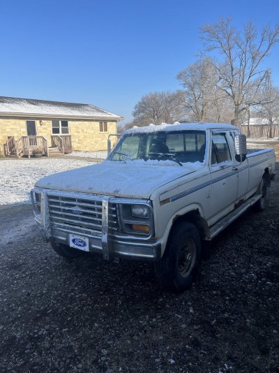

And then this… thing it does that isn’t a problem but sure as hell is weird…

Here’s a picture from a little while ago
