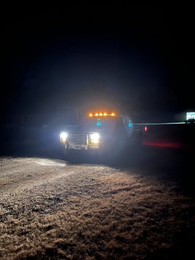

Got the junior West Coast style mirrors on them, and wow. Those are great. I really like how they look, and best part is, with the small round convex mirrors, there are no blind spots. It seems people either really like them or really don't. All good, everyone has their preferences. The truck looked a little dorky with those mirrors at first, but then a couple days later I installed the cab lights. Oh man. That did the trick in my mind. Some people with different taste might not agree, but in my opinion that made the truck look... almost sharp for as rusted and worn down as it looks. Can't quite place it, but something still doesn't look quite right, even if you ignore the rust. I really noticed it when I removed the Ford logo front license plate to flatten it back out.

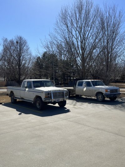

These pics aren’t very good, but here you go
