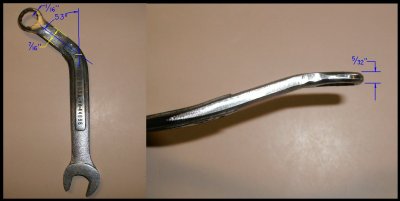

Well, after spending the best part of the weekend working on my daughters car, I was finally able to spend a little time on Henry. After running incredibly strong immediately after installing the Baby Moose, the performance slowly degraded. I thought it was solely the viscosity difference with the WMO in the cooler weather, but there was a little more to it than that. Stuttering and blowing white (gray) smoke at higher rpm's on diesel or WMO mix was the give away. I Searched OB for advance direction on the IP but got annoyed after reading for ten minutes and not finding it, then broke down and looked in my Chilton's... Oh yeah, that's right, towards the passenger side. I quickly realized that a regular 9/16" wrench just wasn't gonna cut the mustard for this job, and maybe that's why the pump nuts were only on there just about one inch pound over finger tight (BILLY!!). Anyway, it was a good excuse to go ahead and make an IDI specific tool that'll probably see use from several members, so the need was there. Tools required: torch, 9/16" box end wrench, vise, pipe, grinder/sander.
Secure the wrench in the vise, heat bend area until red, slip pipe over other end and pull until proper angle is attained. Grind to dimensions shown.
I can't recall how much the "proper" tool costs, but it's guaranteed to be more than I'm willing to pay, and be harder to locate than I'm willing to deal with, therefore... I hope somebody gets some use out of this!;Sweet

How much offset did you put on the flat side of the wrench? Thanks. Steve

Steve- I didn't mess with the offset at all, it's completely Craftsman stock. BUT- I will say that if I made another one, it would be with a NON-offset wrench, as the offset causes an interference with the radiator hose causing you to have to take short rotations before re-placement.

thats funny I just made one this weekend to remove an IP. took a cheap craftsman evolve wrench and bent it in the middle and near the open end.

Great minds...... Why near the open end? My thinking was that the box end is a twelve point, so that would give me twice as many positional options for working in a confined space. But no matter, did it work OK for you is the question?

yeah it worked great the pump is on a UPS truck somewhere between here and delta, PA. I did the open end because at least on the top bolt there did not seem to be enough clearance between the bolt head and the pump to slip a socket or box end.
