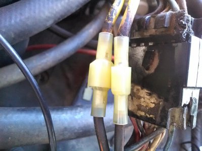

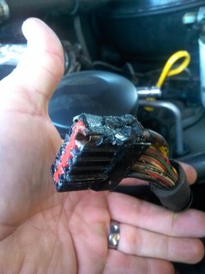

So I found the connector at the passenger side fender melted. :confused: I am guessing this is where my problem is at. I will pull the wires out of the connector and wire them up out side of the connector.

So here it is after I did connectors to the 10g wires. Tomorrow morning I will try to start it with the new connections and see if it solves my problem.

Yep, that melted plug is a common issue on the IDI's. Looks like you took care of it ;Sweet

Yes the main engine wire harness plug will melt when corrosion gets in there. Sad idea of an engineering mess. I found mine melted too one morning start. So I went to an auto sound shop. Bought some speaker cable that was 6 gauge. Got the lugs and made my own feed to the controller. I have power to the controller now with no problems. A bit of caution working around this feed wire. Its powered up all the time with full 2000 amps ready to ground and burn up. So is the alternator heavy charge cable as is the starter hot all the time.
