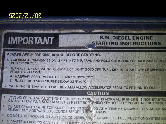

Wrong on the IDIs. Here's Ford's recommendations from my sun visor sticker. See #2. Not that they won't start without the pedal depressed, it's just what's recommended by Ford for easier starting.

Along with adding some fuel, it lets the fast idle solenoid extend. It's strong enough to hold the throttle open, but not strong enough to open it by itself.
