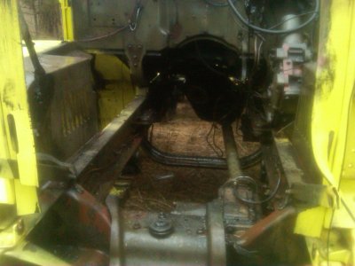

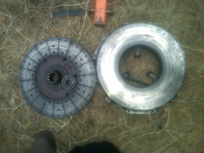

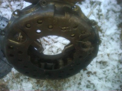

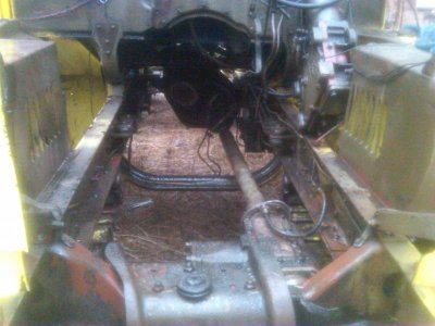

Just some pics of the engine bay. Trying to get working on getting the engine installed this week if I have motivation. Also posted some pictures of the clutch pack and flywheel that came out of the original engine/trans combo for the spicer 6454 tranny.

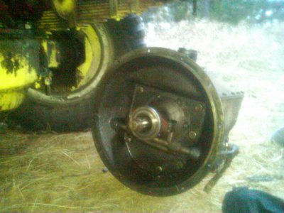

Pics of the spicer 6454 5spd direct drive transmission. Yeah it is pretty heavy. Wish I could find a way to get a output yoke like it has for a C6 or a better built automatic.

If you want a REAL stout automatic, you can always scrounge up an Allison commercial box out of a school bus or some such critter. They shift a bit on the *brisk* side when unloaded, but they can handle hauling insane loads without complaining and you'd get that nice big output flange to rig up some real stout driveshafts to ;Sweet

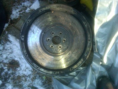

Did you happen to get any pictures of the flywheel when it was still mounted up inside that SAE setup ? or do you at least have a few pics of the flywheel ? Would like to see how it was all laid out in there.
I should have a repair manual for that spicer box and its assorted related parts if you need a copy

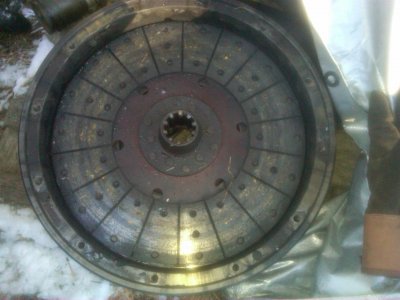

Here are some pics with the flywheel. The clutch pack sticks out about 3 inches from the SAE plate.
