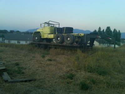

Hey Simp post up some pics of this truck inside and out when you get a chance. I'm interested in seeing the whole rig thats getting the transplant

Here are some, will take more tomorrow.the one looks crappy cause I was making a hard top for it rather than spend $700 on a replacement one. So i did the wood hard top for $60
