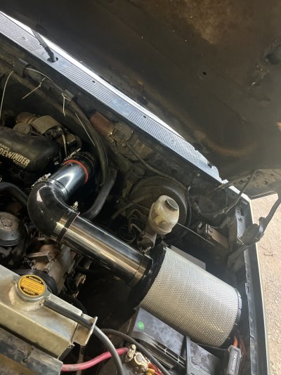

Hello everyone! I’m new here and could use a little help.
My 15-year-old son bought his first truck about two years ago. It’s a 1993 F-250 4x4, 5-speed with the Banks Power Pack. Over the last couple of years I’ve learned a little about these trucks, but I grew up around 12-valve Cummins engines, so these IDIs are definitely a different animal!
Here’s the issue. About a year ago we had the injection pump rebuilt, and while it was apart the shop turned the pump up a little. After I reinstalled it, the truck ran great. It smoked a little more than I liked, but it had noticeably more power and would cruise at 70 mph without much effort.
Since then we’ve hauled a few loads of hay with it, and now it’s a completely different truck. It struggles to do 60 mph. Sitting still, it revs clean and sounds normal. But once you’re driving it feels like the injection pump isn’t getting full rack travel. I have to keep the accelerator on the floor just to maintain 60 mph.
Could the timing have slipped? Is there something else I should be checking first? It does make boost, but it’s mostly on the low end. Once the RPMs come up, boost falls off and it feels like the engine just runs out of power.
I’m not sure where to start, so I’d really appreciate any advice from those of you who know these IDIs better than I do. Thanks in advance!

OK guys so we played with it this afternoon I advanced the timing but maybe barely a 16th of an inch more like a 32nd from my Mark that I made when I took the other injector pump off had a longer start. We took it for a test drive still wasn’t good. Brought it back to the house actually found that the throttle linkage was hanging up and would not let him get WOT I fixed that still prolonged start took a test run. Truck did much better but we only hit about nine psi so we brought it back to the house and let it cool off. Rolled the injector pump back to the original timing mark fixed the throttle linkage for what we think will work for right now. this test run We did a hair over 10 psi click it had a quick startup and a lot more responsive while driving like I said, got a hair over 10 psi. I think I’m gonna try retarding the timing and see what she does.
You know, sometimes it’s embarrassing doing these things because you can’t figure out problems until you start asking questions like you can’t figure it out and then when you really start working on it you say it’s just something simple however I think the truck should be making more power than what it is right now and it is definitely more responsive. We’re able to give it more throttle, but I feel like they had. The timing advanced too far so we’ll see as far as the fuel filters the fuel filters actually new. This truck hasn’t had 1000 miles put on it since the injector pump was replaced on it. He only drives around the farm so I guess y’all standby. We’ll see what I get out of it when I retard the timing a little how many psi should this truck be running with the banks power pack on it? I’m curious I’m not sure trucks I used to drive from this time era would do 30 to 40 psi I don’t think this truck will do that so is 12 the magic number 13 or is it just 10?

What do you mean by "Banks Power Pack"? The only thing that comes up is an air filter housing for non-turbo engines but you have a turbo.
Also, is there an EGT gauge installed on the vehicle? If not I would do it sooner than later and then you can safely increase the fuel delivery on the injection pump.
