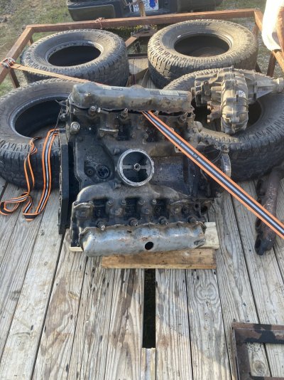

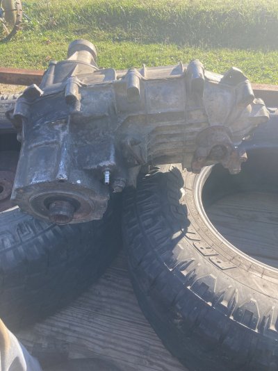

Sorry for long delay but I put engine back together and not much difference so I call dude and told him engine was bad and to my surprise he gave me another engine, a bunch of parts including a good BW T Case. So I think I’m just going to throw it in the truck. Only problem is it’s a non turbo but I can fix that while it’s out. Just build it with the other turbo engine. Valley pan, head studs, oil cooler and seals and a bunch of other stuff all came with it. Engine was good running they just switched it out with a factory turbo model for his son and I think he ragged it out. What would you guys do

If this latest engine runs, I'd reseal the oil cooler and put it in the truck. That way you can take your time and build up the other one how you want to. A N/A engine will hold up to quite a bit of power. It will have no troubles holding up to a stock Factory Turbo.

That’s what I’m leaning towards just seal it up and run it. Then try and rebuild the turbo engine correctly. Thanks for the input
