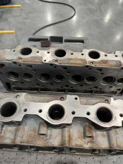

I also got my cylinder heads nice and clean today. Once my new exhaust valves are here I’m going to sit down and measure all the clearances. Got a quote from a shop today to do a valve job and they wanted 900$. That seemed a bit high. I’m going to have to shop around.

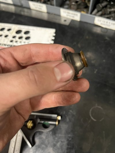

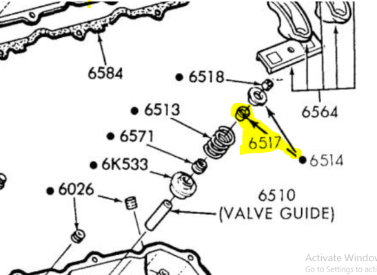

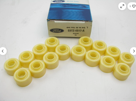

Ok I have done some more research on the little plastic piece on my valve spring cap/retainer.

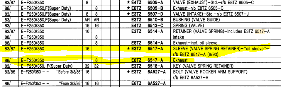

Here is a breakdown of the ford illustration for the 6.9 IDI valve train.
I believe part 6517 (E3TZ-6517-A) is the piece I need. Ford calls it 'oil sleeve' and it appears that 1983-1987 (6.9 IDI) you need 16 of them. One for each valve. This makes sense because they were on both intake and exhaust valves on my engine, at least what was left of them. I'm not sure what the purpose of this part is? Maybe to hold oil on top of the valve stem for lubrication?
Then it appears in 1988 (7.3 IDI) they changed to only requiring them in the exhaust valves and changed the part number to E8TZ-6517-A This part number looks significantly different than the E3TZ-6517-A that is found on the 6.9 from 1983-1987
I have 'upgraded' valve stem seals for all 16 cylinders from classic diesel design. I'm wondering if these seals eliminate the necessity of E3TZ-6517-A.
One thought I had was that in 1983-87 they just put the 'oil sleeve' on all the valve spring caps to ease manufacturing. Since the part was removed from the intake valves in 88 and changed to a new part for the exhaust valves it makes me think it has less to do with lubrication and more to do with preventing oil from intruding into the combustion chamber via the valve guides.
Thoughts?

When I redid my heads and the ones on my dads truck, I just put regular push on stem seals, no need to overcomplicate things.
4,209
4,793
@Nero ok I see. So all these different seal pieces are just the old style valve stem sealing system.
Correct. I think you can still get them, but I went with just regular style seals, so far no issue. I used a basic Felpro upper gasket set, and it came with them.

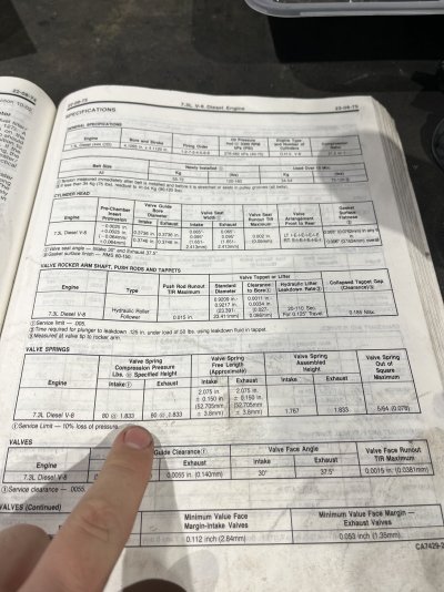

@rreegg I have a a 7.3 FSM and it looks like the 7.3 idi valve spring spec is 80 pounds at 1.833 inches compared to the 6.9 spec of 60 pounds at 1.790 inches. Maybe I have some updated springs because it was the second to last year of the 6.9? Not sure.

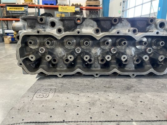

Made a bit of progress today. Spent the morning getting a core support for the truck at the junk yard and then dropping it off at the sand blaster. I discovered I have a stupid 37”x15” radiator that is hard to buy a replacement for (mine was leaking) so I decided to upgrade. I will now have the “super cooling” upgraded radiator and more clearance for a intercooler.
On the engine I worked on the front cover, the top water pump weld nuts were stripped out so I cut them off. I will weld new ones on. I also cleaned all the head bolt holes in the block. They have been soaking woth ATF/aceton for a few days. I made a home made thread chaser with a head bolt. This worked really well and all the threads feel smooth. Another note on head bolt holes for future readers. Be sure to check the holes in the head. Some of mine had a TON of rust and crap that was really stuck on. You will need a high quality wire bore brush and several rounds of cleaning.
Those are usually the bottom row of bolts. If you look while the heads are on, those bolts and holes are exposed. Yes the head bolt thread cleaner works well. That's what we used when I worked on these for a living.
