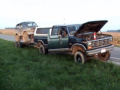

well to make a long story short i blew a headgasket on the way to a trail ride and had to keep stoping to re fill it on the way home we were about 45min away from our house and the temp guage burried and the light came on i was in the middle of nowhere with my 14month old daughter and my wife. i shut it down and pulled off in the ditch., popped thehood to find the rad had let go causing the sudden overheating. well we had someone tow us home and i got a new rad but apon further inspection i found athat i had a knock, like a wrist pin, or a bearing so, I AM IN NEED OF A RUNNING OR REBUILDABLE 6.9L!!!! it can just be a long block i have all ned injection system, if not in here could someone point me in the right direction?
:confused: :mad: Please help!!
