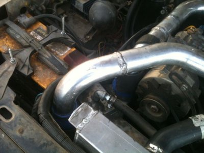

Right now I'm running without a functional intercooler - I've got a water/air intercooler but only have the air side hooked up at the moment so it's really not doing much.
I wouldn't run one without and intercooler though - at 20 psi the turbo outlet temp is somewhere near 300*F, which translates to a significant amount of heat being dumbed needlessly into the engine, as well as less dense air going in.
That being said, it seems to work okay without one. I see a max of 1150-1200 for egts and no real overheating issues. I have noticed that I see a significantly faster rise in coolant temp for the last little bit of throttle which I suspect is at least partially due to the lack of the intercooler.

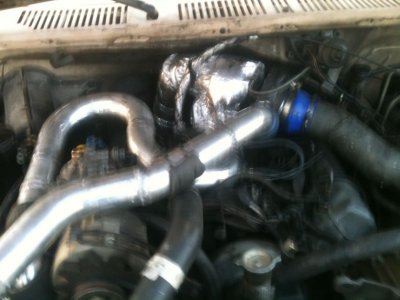

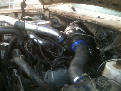

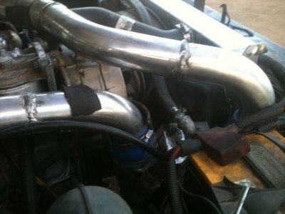

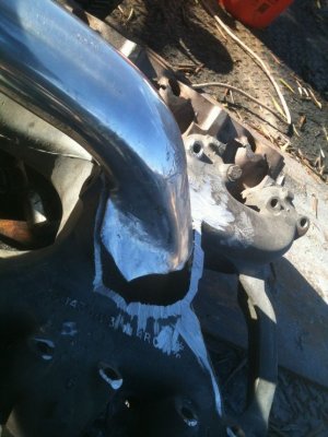

On my rig the turbo sits higher and further forward than a stock unit, and I built a custom intake setup with the center section cut down in height to the top of the runners and a 2 1/2" elbow welded into this. Let me see if I can find a picture....
I don't honestly think you're going to be able to do it as a weekend project - there will be some little thing that will screw you up.
I don't seem to have a good pic of the intake setup, but here's one of the mock up prior to welding. The gaps between the intake casting and the pipe were all filled in with small pieces of aluminum plate.
Also attached are a couple pics of the piping setup and turbo.
