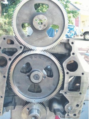

Your issue sounds like timing. Not knowing your rebuilder or if this guy knew the cam gear has 2 distinkly different timing marks. He may have set it 180 degrees out of time. Surprisingly these engines will run 180 degrees out too but not well and smoke horribly. This is what I suggest you do to be sure the cam gear is timed correctly to the injection pump gear. I took these pics of what the gears will look like if they are timed correctly. You will have to bring the engine to the damper top dead center mark. That's the short fat tube at the damper. Make sure is clean and you will see the zero mark thru the center of that tube. Now remove the small cover on the front of the injection pump gear housing. Look in and see if the drive lug is in the 4 o clock position when the damper is at top dead center.

The dowel on the IP gear can be at 10 O clock and still be correct as the crank makes two revolutions for each one of the cam.
You are correct but... If you find the damper at tdc and the dowel is at 10 o'clock then the 2 valves wont be closed. Sadly only way to know if both valves are closed is to pull an injector or glow plug on number one cylinder..
