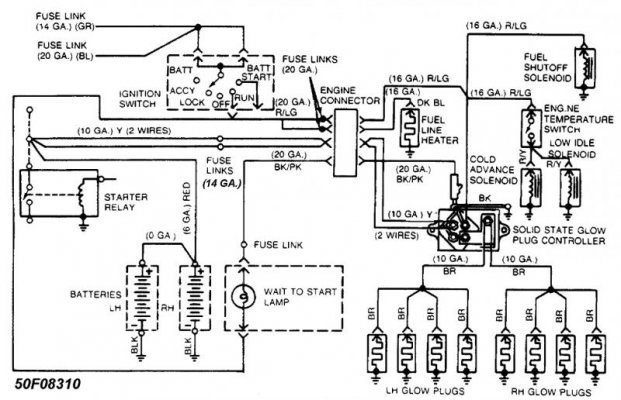

Ok so now I thought my wiper motor was bad changed it with used one still same took little black box out wired directly still same how do I find out were issue is

You need a volt meter and a wiring diagram or you’re guessing and as you’ve seen throwing parts and money at it without change.
gnathv
Oct 18, 2007
1,062
532
Athens, Al
Maybe this will get you started
