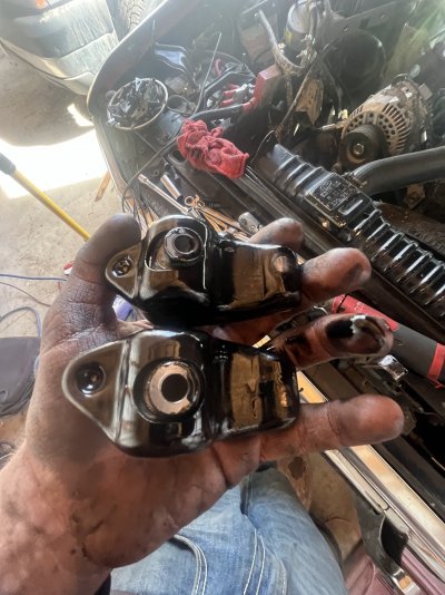

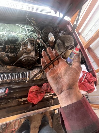

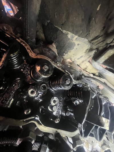

Don’t really know what I’m looking for but there’s virtually no wear pushrods not bent
How do you reinstall the rockers?
Put them back on and torque the bolts down. Be aware that your style of rocker uses the aluminum pivots that are known to break. There is no replacements made. You just have to upgrade to the 7.3 style rockers.

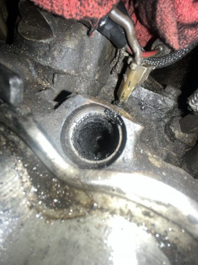

Well Injector bore of the problem cylinder the washer was definitely not sealing
Swapped Injector 1 and 2 and it moved to 2 so it really was the injectors this whole time
