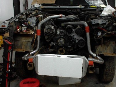

that's a "hershey kiss" intake horn from a ATS IC kit. no longer in production.

Well there ya go.. Thats a nice ATS intercooler setup too Calvin. How long ago was that pic taken. Bout 8 years back.. Any thoughts about how its mounted and how its running. I have never seen any used ATS intercoolers listed anywhere either. They must be keepers.
