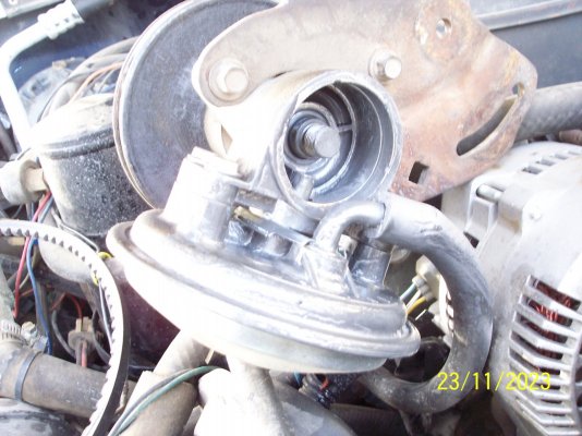

With the engine off the vac dropped from 22 inHg to ~20 over ~hour. Is it supposed to hold vac?
I supposed that it is supposed to, ideally. As old as our trucks are, yours HAS to be in the top .001% at holding vacuum. All of the old rubber parts most likely can't hold a perfect vacuum. With the vacuum pump that I still carry for emergencies, mine would drop to 0 in about 5 minutes after shutting off the engine. After I replaced it, it would take 10-15 minutes. I never did see more than 16.5" of vacuum out of that old pump so it wasn't the best even when new. Now, with the two after that, I get 22"-23" while driving so I'm happy with that.

My old vacuum pump would have good vacuum when I first started the truck but would quit working after driving for a while. The vacuum pump I replaced that one with four years ago just got weaker and weaker on vacuum before being replaced. Apparantly they have more than one way to fail.
Including falling apart.

I still have the used spare from @BlindAmbition with the bracket and pulley. I had to use it on the RV twice when two new pumps failed. First just quit pumping and the other fell apart. My lifetime pump is from O'Reilly's. I made sure to keep both when I got the van. The pump that came on the van was put onto the RV before it was sold. So the van is running the lifetime pump with the good spare under the passenger seat. And I carry around the pulley puller tool, too.
