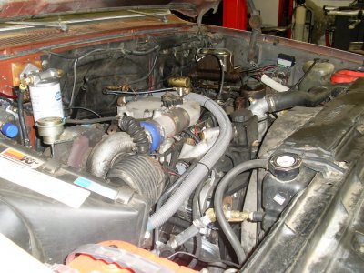

I put in a wastegated TE06H that was robbed off a '93 F350 4x4 onto where a factory 6.5 turbo went. Night and day difference. the '87 C2500 4x2 hits 10psi immeadiately and literally will leave my '92 F350 CC sitting still.
very minimal hassle, the mounting flange was the same (T3) and the oil return was the same. the compressor side was offset forward just slightly.
here's the pics.
