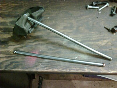

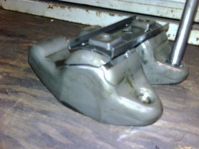

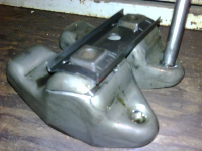

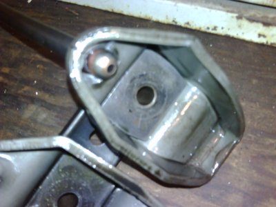

I got to some trouble shooting last Saturday. After disassembling some of the duct work I pulled the rocker that was punched and the one next to it. Both pushrods were bent and the other rocker was severely cracked at the base.:eek::puke:
I installed two used rockers and lifters and guess what..............ran perfect all the way up to the governer, no missing what so ever.:angel: I am going to cross my fingers and put it together for a run with the used parts.

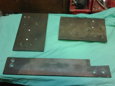

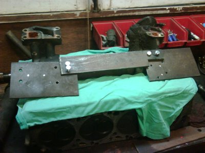

Slowly but surely progress is being made. The turbo should be back next week. The rebuilder took a huge hit with the Hurricane Irene. He said that the door knobs to his shop were under water.:eek: He also mentioned that the turbo stayed high and dry:angel: however final assembly would be postponed a week of so on account of the flooding. Best wishes to Shawn at Scroll Products.

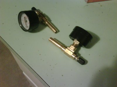

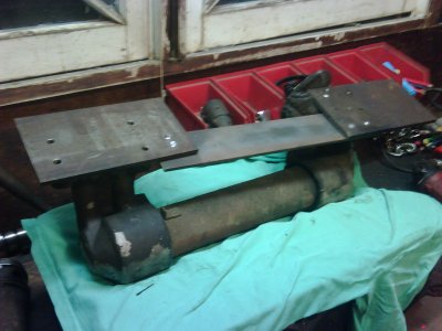

Meanwhile I cut up some 1/4 plate to make a test jig for the oil cooler and got some 1/8" pipe hardware to apply shop air. I still have to drill and tap the plate for 1/8" tapered NPT. No biggie, just on the list as next thing to do. I am going to test 3 oil coolers with the junk rubber o rings and get the Ford good stuff for final assembly.;Sweet As usual, some pics.:sly

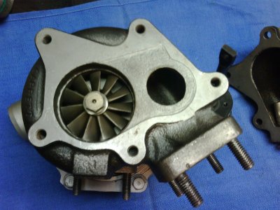

The 360 thrust bearing is not worth the money for out boost levels and oil change intervals. besides it puts an extra rotating sleeve on the shaft, less parts less trouble.
I have orings if you cand find them. Tousley ford has the best deal going.

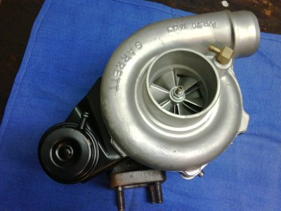

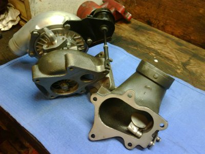

I pulled and replaced ALL of the pushrods. Evey one was bent.:confused::puke: I replaced all of them andthe engine runs now like it is supposed to.I got the oil cooler in yesterday, the turbo is to follow this afternoon. I am almost afraid to finish.;Really Keeping my fingers crossed that this cures things for some time to come.:angel:

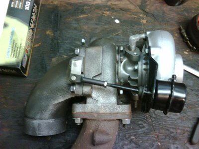

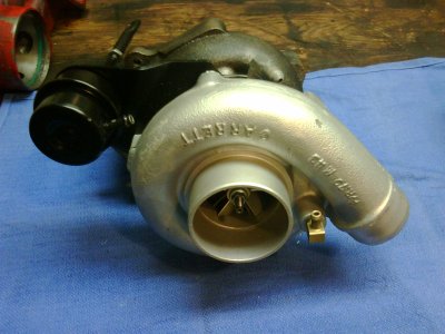

Here are some pics of the freshly rebuilt turbo.:sly Time to get dirty, wish me luck:D:angel:
