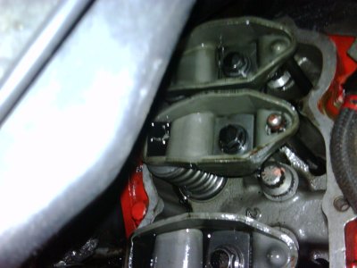

I got back to business in the shop today. So, take a look at this pic and tell me where the problem lies. I can not believe that the pushrod went right through the rocker arm.:puke: I'm guessing the guide is a bit tight on that valve, not the rest of the valvetrain as I was worried about. Now the question lies, did I harm the lobe, lifter, or pushrod? Tell me what you guys think.:eek::bs I call bs from a reman engine-cuss

Goose, that usually happens when there is way too much valve lash. When the pushrod has a chance to pick up speed before it hits that sheetmetal rocker, it just punches right through. I have also seen a hydrolocked cylinder do that. The pressure can be so high in the cylinder, the valve refuses to move.
Do you have another good rocker and pushrod?
Also, those lifters can be put in wrong. But I think you said you did not realize your rockers were loose before running it, and that could have started to tear up that rocker.

Any reman engines I have seen all reuse the core rocker arms. It's standard practice. Even on engines where contact between moving parts has occurred (like pistons hitting valves), the weak link should be the push rod. Never seen one blow clear through a rocker arm like that.....

OK, I went back and re-read this thread. You said two rockers were loose. I would replace both those and the two pushrods. Your rocker that did not fail could be peened up. This might not be recognized by eye but all that noise was probably causing some deformity.

Not a real common occurence on these engines, check for coil bind, put an oil pressure gauge on it, a mechanical one. If you dont already have it, and they are 7.3 rockers. But who knows where they are made, Send it back to promar, dont tell them the cam change or they will bs an excuse. get some new rockers from them. Also was the oil cooler on the new engine? If it was, they most likely washed the header in a dishwasher and the relief rusted and it will spike the pressure, saw it happen on "on da roads" truck.

Hey, that makes a lot of sense. Too much oil pressure could pump up those lifters. Hopefully it was coil bind and not piston vs. valve.
This is why I do my own work, even when I can afford to pay someone else. I would be trippin' if I spent a couple grand on that motor.
I would repair the damage to the valvetrain and check that oil pressure relief. I would probably pull the oil cooler and inspect it.
Once you determine what is going on, if it is Promar's fault, I would be asking for a partial refund. But don't jump the gun, make sure you have it all figured out before making any demands.
