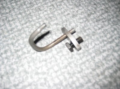

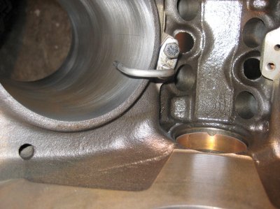

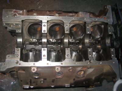

Oil squirters on my 1986 6.9, only one bolt holds them in.
682
Boy o boy did it take a long time for someone to show or say the bolt in squirters have just one bolt holding them in..... Anyway. Making up a set of pressin squirters would be tuff. Getting the metalurigacial prosess done is thw hard part. Then the ends need to be crimped down so they are the correct opening. The bore diameter is 52 thousands so welding them up and drilling them out and finally using a multi fluted reamer that size and its done that far. The actual fabrication and press fit is another issue. Making one would be ok but having to make 8 would be trouble. There are actually 2 tools. One is for the removel & installation and the other tool is for the alignment of the installed nozzle. I don't have a picture of either but I think I have the Rotunda part number for the tools.
