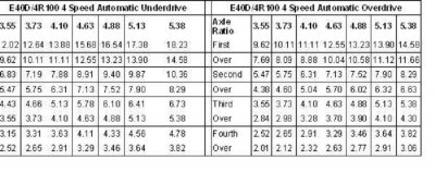

I did some calculation once for overdrive/underdrive comparison and bigger tires. It was pretty interesting.
I was thinking about going to 245/19.5 wheels. I should improve safety and load capacity while towing, and have extra room inside the wheels to do a rear disc brake conversion. Am I off base on these ideas?
I was thinking of adding a US Gear overdrive before I started thinking about the 245/19.5. But, maybe the underdrive will work better.
Stock 4.10 gears
225/19.5 = 3.92
245/19.5 = 3.60.
Final drive ratios:
US Gear OverDrive .80 over
215/16 = 2.32
225/19.5 = 2.22
245/19.5 = 2.05
US Gear UnderDrive 1.25 under
215/16 = 2.91
225/19.5 = 2.78
245/19.5 = 2.52
These #s are taken from US Gear chart for 4.10 and 3.55 ratios.
With 8 speeds of underdrive and 245/19.5 things would be comparable to 8 speeds of overdrive with 215/16 except I'll get a granny gear of 12.02 vs 11.11 stock.
Don
