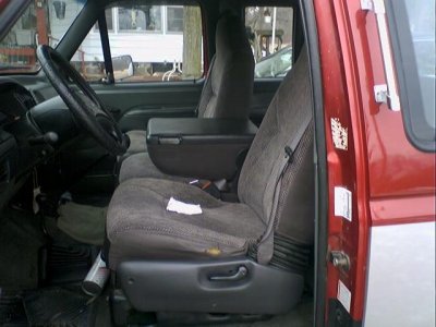

My '93 has had a '99 Ram seat in it for 4 or 5 months now....
I think I have a pic. or two:
My Ram seat is all one piece that can be seperated but, it was all one piece when I took it out of the Ram and put it in the bed of my truck and brought it home. And then we installed it that evening. Took maybe 2 hours to pull out the buckets and console and put in the 40/20/40.... I really like the seat in there. Makes my truck useable for the family now....

Hoss6.9, so did the Ram seats bolt right in? If not, what kind of fabrication did you have to do? I dunno if I can bring myself to put goat parts in my truck, but it does look nice.

i'll see if i can get a few pics of mine up they are out of an 02 f250 supercab. kinda tight in a single cab but still comfy if you ask me:D

Must be because I have power and the older generation seats.....
Hoss what did you do with the stock seat belt?

On my generation seats - the passengers seat when flopped forward will disengage the seat slider and allow the passengers seat to slide fully forward then for sliding it back just grab the lower portion of the seat and slide it back then shove the seat back and bingo it will all be reset to where it was before (recline). Now if you just flip the seat back the seat will remain slide fully forward and you will have to operate the lever under the seat to slide it back.
Drivers side seat does not do this, you can flip the seat forward but will have to run the seat forward then back again after they enter. I suspect that the newer generation seats are like that - my buddies 99 dodge has quad cab doors so it's not needed to flip the seats forward to get in the back.
