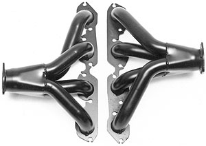

Thanks for the input guys its always great to hear ideas from other people when doing a custom fab like this. The R&D flanges are 3/8" thick so they should work well. The 460 headers and BBC header spacing look like they should be close, I will let you guys know tmr morning when I go parts store hopping and start gasket matching. Next is to pick out what header style will fit the best and at the same time be functional for maintenance and ease of install and removal, while out flowing the big 3 kits!

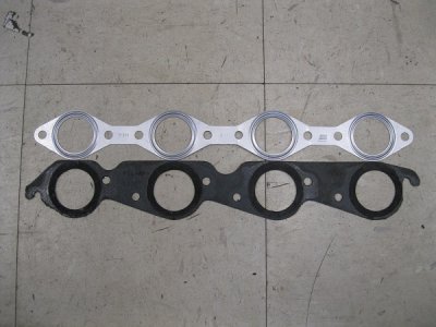

Good news guys I just got back from the parts store with the 6.9 exhaust manifold gaskets and layed them over top of a set I have lying around for a BBC. The port spacing is EXACTLY the same, just the BBC ports are a hair bigger, like a 32nd lip around the port when layed over the 6.9 gaskets. BBC headers will work PERFECTLY with a flange swap!

Also these are the headers I will be ordering as well, they are shorty's for a BBC from hedman, looks like they will clear the cross member ok, but time will tell... not bad for $180

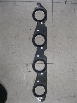

Here are pics to show just how perfect the ports are lined up between the 6.9 (silver gasket) and BBC (black gasket)

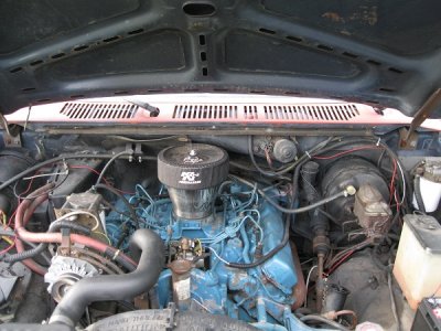

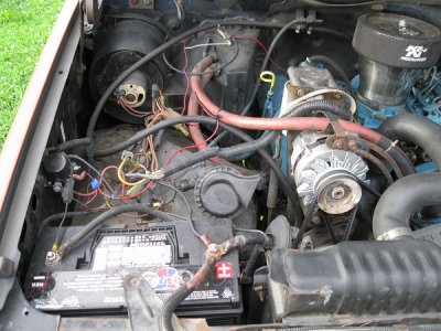

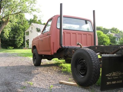

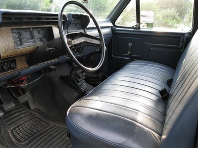

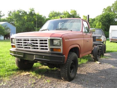

Here are some pictures of my rig as of early today, so you guys can get some good before and after looks at the truck... but sorry, no dyno numbers,:dunno maybe I will break down and go do some runs just to see what kind of difference I will achieve.
Notice the crooked front bumper lol need to tighten up the drivers side bolts tmr. ;Sweet
And I have a new brake master cylinder just slackin and haven't put it on yet...
So, the diesel has the holes that are diagonal, and the chevy is the straight across bolt holes correct? If the headers had enough metal in the correct areas,, could you re-drill the header and use the chevy flange? If you had to you could weld some of the holes shut on the chevy flange and re-drill?
6D9N24/7
Jul 11, 2013
18
Frederick MD
The diesel gasket is the silver one with the straight across bolt holes. re-drilling the BBC flange may be an option but I have a feeling getting the holes all lined up correctly may be an issue, and getting it in the drill press may be a pain. I might just drill 2 "easy to get to holes" out of the BBC flange for mock up purposes, then I could check the flange clearance and fitment on the truck and see if it may be an option.
My original plan was to leave like 1/8" of BBC flange around the pipes, instead of just cutting them off, that would ensure a good flat surface to mate the two flanges together with and some meat to let the welds really bite.
