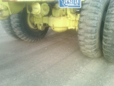

I thought of adding a turbo but with my 4spd and 4.56s she is pretty loud at 60 turning close to 3,000rpms and she does just fine without the turbo. She will outpull my wifes 94 turbo with 4.10s and a zf5 on the same hill. I will have to find the video to post that shows me rolling smoke in her face :D
As far as dependable transmissions for bigger Hp you can always try a Spicer 3053A with a .85 5th gear ratio and you can buy the overdrive kit that allows for .68 final drive. I have the t-19 with a np205 behind mine and it seems to hold up great. Better than any 208 or 1356 ive owned.
http://www.youtube.com/watch?v=udSfWWAr_do
I am thinking however that the leaf springs on my big truck would be better suited to handle the loads I tow.

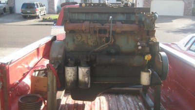

DT's are a shade of light blue.
Here's a few pics I just snapped of a 92 DT 360 out of a school bus

very nice!! now hurry up and rip that thing out and put the new one in. :sly im very interested in seeing how well it fits in one of these pickups. you might even be able to make a dent in the price of adapters with the scrap value of the one in it now :thumbsup:

That A pump on there can be easily modified to bump up the power for reliable hauling. But, if you want to really go crazy, you can put a hot P-pump on there, injectors, twins, and ........... well the possibilities are endless.
