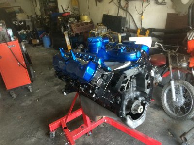

finally! the long awaited engine build.
13,324
3,897
Engine block and heads.
Degreased
Primerd
Painted
14,778
483

Heads are on.
Felpro HGs
Arp studs to 125 ft lbs
And had to rest intake nd valve covers on for a Motivational pic

some progress.
stock valvetrain is complete.
i need my truck, so this round of mods will be cut short.
no time to mess with the roller rockers.
i will be putting them on a different engine to work out issues with pushrods.
new block heater, valley pan, intake, valve covers, injectors and glow plugs all installed.
ip, ip gear cover, ip gear all put together, at correct timing mark and locked down for front plate install tomorrow
