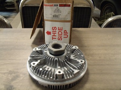

well it is still pretty cool around here. I think I will put another motor raft t-stat in. Can you get one that runs cooler than I believe 190-195* that is in there now? Do they offer a 180* stat. I am also going to get a fan clutch since you can no longer get OEM what is the next best, a Hayden heavy duty?? Then I will just have to wait and see when temps are warmer.

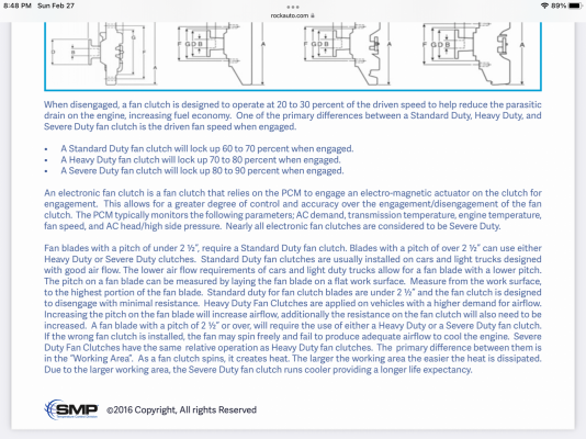

Here’s some good information.

Thanks. I did buy a motorcraft fan drive hub. Will have to wait till hotter temps. I may still order a fan from you…..
