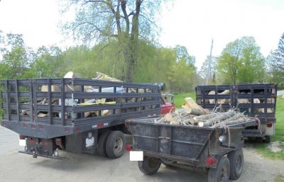

I work at a shop that specializes in cooling systems. A Windstar fan,lincoln,taurus ect can't even compare to a stock mechanical fan with a correctly working fan clutch.ya 240 is the upper end of safe. But an idi pulling a load of toys up cajon,grapevine or mountain pass will boil over with electric fans
but there are those of us who don't need electric fans to compare to mechanic ones because we don't haul toys up cajon,grapevine or mountain pass.:D
not to say i don't work my truck however either.;)
attachment.php
i dare say there's a couple people around this forum not doing as much as this either.;)
the goal isn't to match the power robbing and economy killing stock mechanical engine fan.that would be pointless.the goal is to keep that power and fuel that a stock,power robbing and economy killing mechanical engine fan uses, while maintaining safe 210-240F engine temps doing normal driving/play/work duties.
