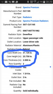

Back from my trip. The cummins overheated a bunch too. Just my luck. but it made it and got me back with some cooling rest stops. this is what my radiator looks like https://www.summitracing.com/parts/sgt-cu1165/overview/make/ford/model/f-150
where are people finding 4 row radiators for our trucks? Radiator hoses get hard and no bubbling.
i have that radiator in my service trucks. no turbo, crawls over CA17, but doesn't overheat.

Update: i installed the new tq converter towcat got me. That made a huge difference in towing. I dont have to have the truck floored to go on flat ground when towing my jeep. I also installed a all aluminium 4 row radiator. When testing today with it being 90 degrees out the truck never got really hot. Would only get slightly above 210. I also bypassed the trans cooler that goes into the radiator. I have three air cooler for the trans and now the trans never got above 200 degrees on the hot side line of the trans. I wish i had done this setup from the start. On a side note i put my divorced np 205 in so i now have 4 wheel drive.
