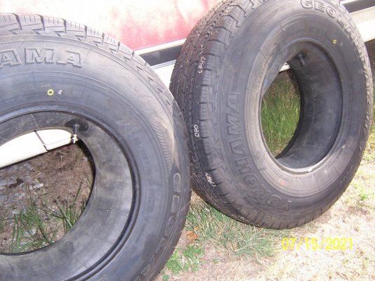

It's a small step, but it's one step closer. I bought a pair of tires. Two reasons for that. 1) so that I can mount them on a pair of rear rims just to be absolutely sure that the 235/85r16 tires will be spaced far enough apart that they won't touch. 2) there's no orifice of my body that can produce the money to buy all 6 tires at once. I can afford to buy them one pair at a time though. I got them ready to be mounted on rims sometime in the near future.

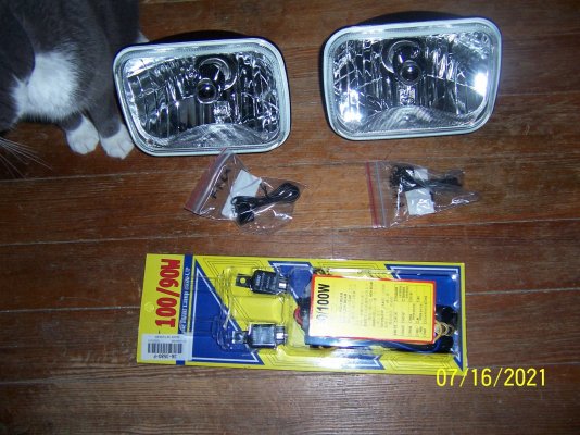

Well now she's going to have some bright, new eyes to go along with her Australian accent. I got a headlight relay kit and a couple of headlight pigtails since I don't remember if the Brick Nose plugs will plug in to the Bull Nose headlights. I also didn't remember whether the relay kit plugs into one headlight plug or two. That's why I bought two pigtails. All I need now is for the LED H4 replacement bulbs from Super Bright LED to come in. There's time.

Well now she's going to have some bright, new eyes to go along with her Australian accent. I got a headlight relay kit ans a couple of headlight pigtails since I don't remember if the Brick Nose plugs will plug in to the Bull Nose headlights. I also didn't remember whether the relay kit plugs into one headlight plug or two. That's why I bought two pigtails. All I need now is for the LED H4 replacement bulbs from Super Bright LED to come in. There's time.
Tell your cat I say hello LOL

I have 2 cats and 1 dog. They all get excited when I get a package. The cats will watch me open it from a distance and once it’s open they’ll see if they can play with it. My dog just automatically assumes it’s for him. I went downstairs to him running around with a v band clamp once LOL

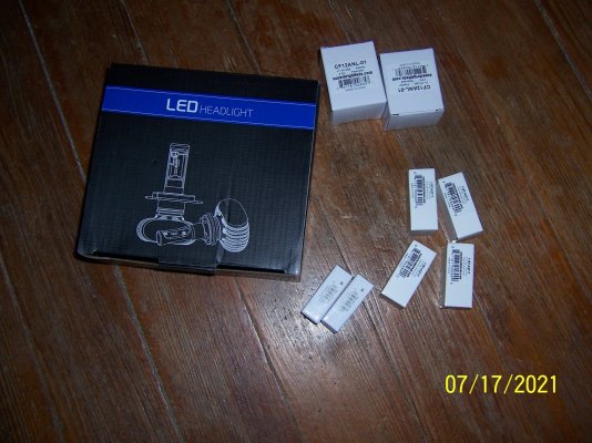

And here's the LEDs. I got the two H4 replacements, four 1157 replacements, two 194 replacements, and two electronic flashers. High dollar, but they should be better quality than the cheap ones on Ebay or Amazon.

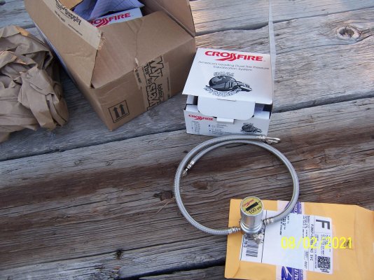

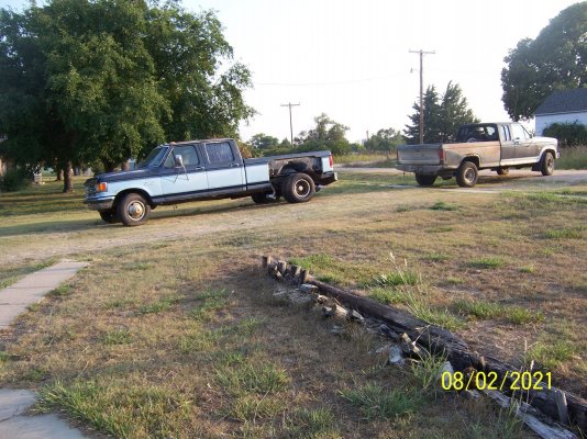

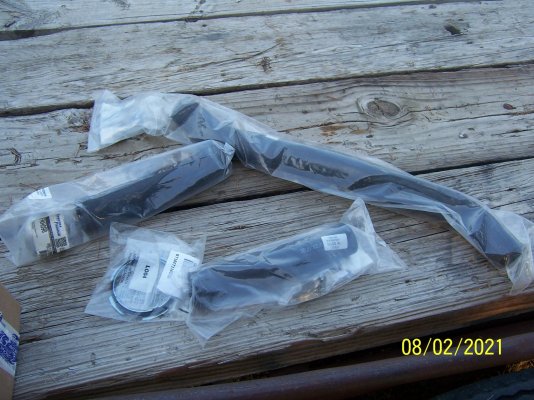

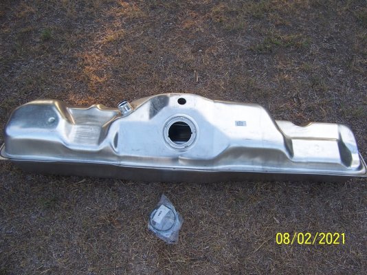

Over the last few days, I got some fuel system parts in. For now, I'm just going to run on the new front tank with the FSV bypassed. Later will come the Bronco tank. The rear filler neck from Rock Auto looks about right. They didn't list one for the front tank on a dually for some reason. I bought two regular ones figuring that I would splice them together somehow, but I'm not sure that they will be long enough combined. I guess I'll see. I also got a pair of tire pressure equalizers. Finally, after I was done with everything else, she got moved up close to the street in front of the garage so I can get started. I'm not 100% sure how I'll proceed from here since I got a twist thrown at me Friday night. I'm not counting on it until I see it in my yard, but I got offered all of a 1992 or 1993 F350, ex cab, dually, 4X4 with a 7.3 and ZF5 except for the axles and possibly without the transmission. It started with a phone call from a friend. He asked if I'd be interested in a IDI engine. Of course I said yes! This truck caught on fire, mostly in the cab. The owner said that he'd take the bale bed and the fairly new tires off and give the rest to my friend. He said that if I help him take off what he wants (axles and maybe the ZF5) then he'd give me the rest. It was running and being used when it caught on fire so how could I say no to that? If it all works out, I'll have a 7.3 to put in while I build up an engine with turbo rods. Now, if the 6.9 turns out to be usable, I'm going to swap that into the Red Truck along with the C6 and the DN2 OD. I'll use it mostly for running around so I'm going to keep it N/A.
