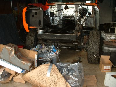

anybody have a suggestion for a heavy duty diesel engine stand. i'd never trust a harbor frieght stand with over $6K of motor hanging off it!!!! :puke: i'll $$$pay for a GOOD stand, and just return it when done if i need to. ;p i'd like to FULLY assemble it, accessories, turbo and all. any sugestions?
we had a AMC 360 tip off a cheesy 3 wheel stand and crush a valvecover and bend a valve. and we had a "heavy duty" stand hold up a IH 392 and we had to use a 4X4 block to support the crank pulley so the stand wasn't leaning down. i'm sure the 6.9 will be a tad heavier then the 392 but not by much. i'd rather have my own stand too so if it takes 6 months no one is looking for it. :D
-Jon
p.s i got the motor back here's a few pictures! ;Sweet
