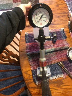

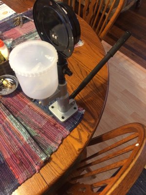

I have one of those pop testers. It seems to work just fine. I balanced a set of injectors with it and haven't had any problems. Also tested a friends set of injectors. I was able to do all the different injector tests no problem. Works as any pop tester would I suppose, but I don't have any experience with others. I'm happy with it!

Yeah it definitely could use a different gauge with smaller increments. And the one it comes with is also not oil filled. It did come with the right adapter line for our injectors.
I wouldn't use this tester to run a business or anything, but it's good enough for a DIY gear head like me that likes to tinker a bit. Also nice to be able to test your own injectors if there's any question as to their condition, or if you 'think' one might be bad you can just pull it and know for sure instead of scratching your head.

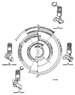

While where at it discussing pop testers, just about any pop tester is OK as long as it will pump up to the desired pressure and not have any leaks.
To check an injector, pump it up to make it pop, adjust if needed to the 1850 or +, make it pop, record pop pressure, pump up second time to within 100#, hold for 10 seconds, if a fuel bubble appears and just hangs there for that amount of time it's a good one.
As precision ground the seat and plunger is a small leak (bubble) is of no consequence as fast as an injector in the engine running pops.
I don't pay much attention to the spray pattern, because an IDI sprays into the precup where it hits metal and disperses, unlike a DI engine where the spray pattern is of consequence, of course the finer dispersed spray the better it is. Everything happens in a matter of microseconds @ 1800 RPM. LOL
Take notice, NO spark plugs. :rotflmao
