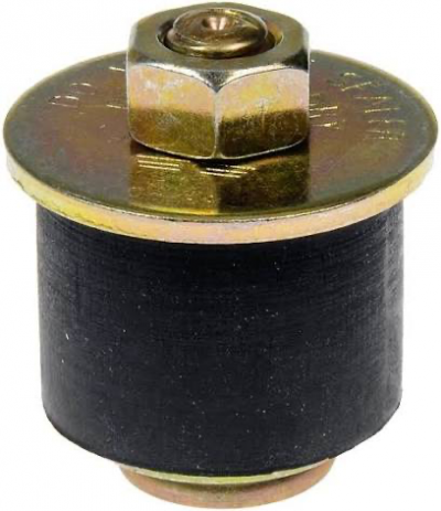

I did a CDR valve delete here not too long ago… bought a rubber expansion plug, cinched it tight in there. Then five feet of inch and a quarter hose going from the crankcase vent to behind the right front mudflap.
