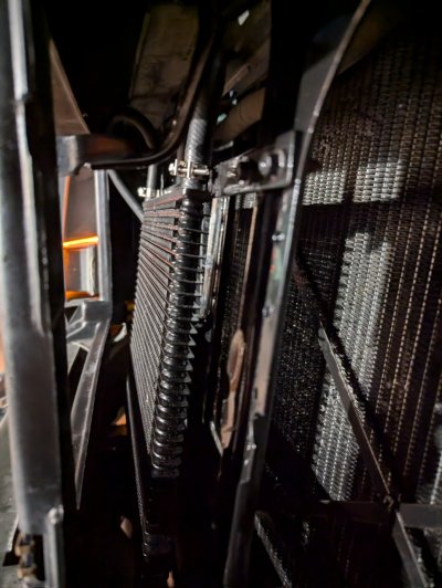

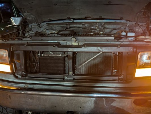

cbrown
Jul 14, 2024
Anchorage, Alaska
Hayden 699, the large size with bimetallic strip based bypass (in Alaska so overcooling can be an issue).
Also replaced the tranny fittings with a 4R100 pressure bypass to 3/8 line, got a set of 95 power stroke stainless cooler lines I tweaked to fit and replaced the radiator barbs with 3/8...
Tranny to in radiator cooler to Hayden 699 and back to tranny.
