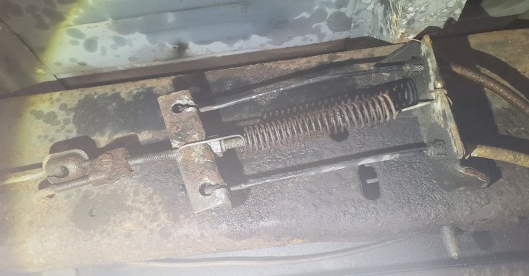

It appears my top cable (pass-side) isn't behaving properly... I get very little movement out of it. Lower cable (drivers side) I can pull by hand and it returns just fine.
#1 are these cables available separately?
#2 is there a way to free it up?
#3 possible issue in the drum/shoe area, maybe a busted spring (I'll pull the wheel to inspect in a few days) I did replace drums/shoes/springs a few years back.

Should be able to get just the top section.
If the rears are smooth operationaly, my .02 is a pinched/damaged upper.
" the fun one to replace "
Check pn either in our stickies or roc autos search deal

The cables like to rust up and stop moving. You're better off replacing them both now but you buy them individually so yes you can replace just one. I've also seen them rub against the exhaust or a shock or something so you may want to make sure they aren't rubbing anything.
I wouldn't feel bad about having to replace some 35 year old cables! I've had to replace them on my 91.

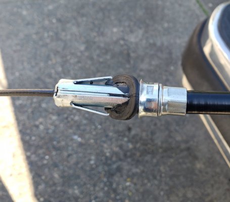

HammerDown
2,158
80
Glenolden Pa

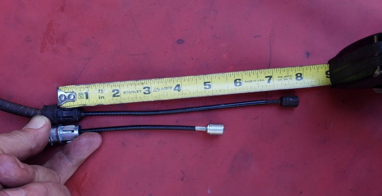

And this is why you need to replace BOTH rear cables at the same time (aftermarket Dorman) isn't a direct match
But even what's in the box is wrong... like it's boxed wrong.

Some of my local Autozone stores keep these cables in stock. Why? because they sell so many of them. They do like to get rusted.
The cables do stretch over time...but I'm thinking not 3" LOL either way, yes replace in pairs for ease of use. Plus they are cheap enough that it's not gonna hurt the wallet to do so.

OE had 4-prongs holding the cable end in-TIGHT to the rear Drum Plate.
The Dorman made in China 'garbage' only has 2-prongs and isn't a snug fit at all.
And... the springs are 1/2" too long, I had to cut the excess off.
