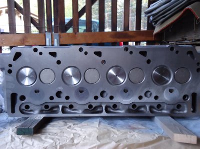

Are there any photos or diagrams showing the difference between the cooling passages between the 6.9 and 7.3 style heads? I've heard of the difference before but never got much on specifics. This is also the first I've heard that the block casting is different too. Interesting.

Here is a 6.9 head.
Edit: Picture is big, to view entire pic right click on picture then select view image.
