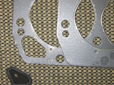

Here is a 6.9 head.
Edit: Picture is big, to view entire pic right click on picture then select view image.

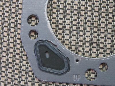

This is a great pic showing the triangular passages on the 6.9 heads. On the 7.3 this passages are round and have a plug in them on the block too. In this pic the areas I'm referring to are at the top of the pic but. This is the lower edge of the actual head. Here is the 6.9 and 7.3 head gasket. Note that the complete passage is not open in the 6.9 head to match the port in the head. The 7.3 head gasket is on top of the 6.9 gasket too.. No reason to remove the plug in the 7.3 block and heads but drill it out to match the 6.9 gasket will work fine.

So do I read corectly that this is a fix for the 7.3 running hot!?

Really can't answer that question. Way too mant variables like. Plugged up radiator. Or a new 3 row dimple core with 12 fins per inch. Just too many other things to say this is the real fix for the 7.3 running hot. Hell some have found not spring in the lower radiator hose and it was collapsing when the engine revs up. but sitting still idling it looks fine. Now thats a tuff problem yo actually see happening. A hose sucking flat.

Strange. If they decided to restrict (but not completely block) passages near the front of the engine to get more flow at the rear of the engine block, I could understand that. But it looks like it looks like this would restrict flow at one head near the front of the engine, and then the other head at the rear of the engine (since the heads are ambidextrous). It could mean more flow to the areas between the cylinders instead of at the far corners of the engine, but still, it doesn't seem to have worked as intended.
I almost wonder if they were trying to get the prechambers hotter for better emissions (now I'm just grasping at straws!LOL).
681
I suspect exactly that. Get the precups hotter for better burn. On the 7.3 engines both the front and back of the heads and block have these plugged off coolant passages. The coolant flow is from the back of the engine to the top front of the engine. Coolant flows from the back of the oil cooler to the front of the cooler. Oil flows thru the cooler from the front to the back at the filter.

Both of the 6.9s I have owned eventually leaked coolant at the rear lower corner on the passenger side. External leak only, original head gasket. I thought maybe plugging those passages was their way of "fixing" the problem.
681
Original 6.9 head gaskets did leak in the lower corners but I do not recall them ever plugging them up. There have been plenty of gasket improvements so now we don't have leaks. Unless you did something wrong when you installed the new design head gaskets. I recall Hsutton had a leaker and finally found out his block was damaged in that area. Had the blocked deck milled and problem solved. I don't recall the 7.3 ever had gasket issues in this are. I also wonder what these idi engines use for head gaskets when they run the engine in the big dump trucks. I do know the water pump is different in the S1600 and the dump truck applications. The did not have the left hand spin on threaded end. They have the 4 bolt flange that many other cars use for the fan clutches.
Well I guess it all fits then. But still, they were taking a hell of a risk to have the head running hotter then the block. You'd end up with permanently different expansion rates and (according to accounts so far) a wider variation in temperature even after the thermostat starts regulating (again, worse in the heads). Its no wonder cracked heads are more common on the 7.3s. Although having said that, the 7.3 doesn't have a reputation for being a guzzler, so it may have partially worked. Makes me wonder why they didn't just run a hotter thermostat. At least that way, they could better control the experiment and reverse it if need be.
