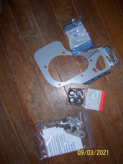

Ford did have plates available back in the day as they knew of the problem.
I have one installed on the 86.
I plan to order this useful part. Since rainy season started here, the there is no rush in ordering nor installation.
Looked at bronocograveyard site and they don't seem to supply instructions for installation for this part. In Chilton's book I have there seem to be not enough instructions - looked for steering column removal section and pedal assembly removal section.
Since you have installed this plate before, do you mind sharing installation steps?
14,976
14,078
They do come with instructions. If you look at the plastic bag at the bottom of this picture, you can see them folded up inside the bag. I haven't opened it up to look at them, so I can't comment on how good they are.
