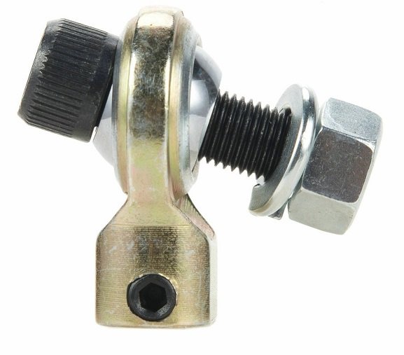

As others have recommended, crawl up under your dash and inspect the pushrod to the clutch master cylinder where it attaches to the linkage from the pedal. When they wear out the problem that you describe occurs. Also problematic can be the firewall cracking and allowing the master cylinder to move.
Bronco graveyard sells a repair kit for the clutch pushrod.
If you install the clutch rod repair end, be sure not to cut your old rod too short!
Also the bushings that are installed in the clutch pedal linkage can wear and result in this problem.
