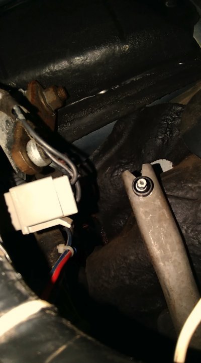

made an effort to get to that area, and found that it is too small to get my head into it to visually inspect it. All I could do was to insert phone camera there with one hand and hold flash light with another and take a picture.
I cannot tell if I see reliably if an area of firewall is flexing or not. Is there a way to inspect the area easily, or one must disassemble pedals area to gain access ?
Rod to the master cylinder doesn't look centered. I'd say that is egg shaped and it's wallowed out the metal on the pedal. I had this happen in my 90 F350 and had to put a new pedal assembly in.

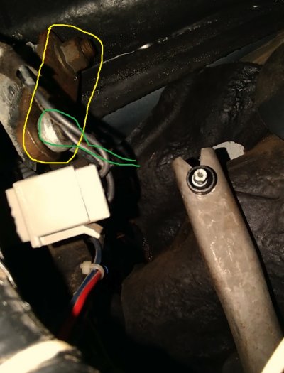

In the first picture I circled the parts which supposedly will need to be replaced, instead of replacing pedal assembly.

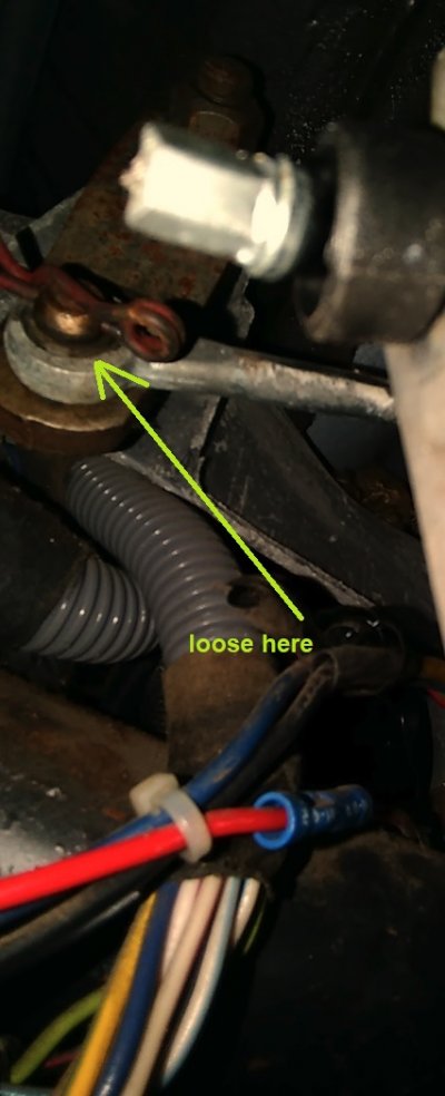

Second photo shows an area where I can sense endlplay.

BrianX128
Dec 3, 2015
1,798
540
Pittsburgh
The problem is it's awful working on any of that where it is in the trucks. Even if you get the large nut off the top part of the pedal arm, it's pressed into the pedal with little burrs that dig in as it goes in so it can't pivot. I tried rigging mine when it started to depress the clutch only if I almost pressed it to into the floor but I ended up just taking it out and replacing it. A few bolts hold it to the firewall, then you disconnect assorted things attached to the brake and clutch, and you have to drop the steering column as well as some electrical connectors attached to the column. It's annoying, but you can probably get it out in less time than you'll spend trying to get anything out under the dash. I'd still check for flexing in the firewall also, you can prop your phone recording video towards your master cylinder in the engine bay and if it's flexing you'll see it.
In this picture, I can definitely see that there is wear in the rod that goes to the master cylinder. There's probably most of your problem. Also, you look at the outside of the firewall to check for flexing. That's why you need a helper to push on the clutch pedal while you look at the firewall around where the master cylinder mounts.
Thank you for your thought.
Given that clutch failure was increasing gradually, and then progressed considerably over single trip, do I have correct assumption that there should have been a nylon or bronze sleeve between pin on that rusted lever and a hole in eyed end of push rod ?
If yes and I understand your point right then my clutch releasing was slowly degrading while nylon sleeve was wearing out, but once it became destroyed then wear mechanism switched to metal over metal and steel rod ate a cavity in aluminum eye quickly enough to cause clutch failure to release over single trip.
I am thinking in a direction that if there is any option to repair my truck clutch mechanism issue without removing pedal assembly then I will explore that option first.
