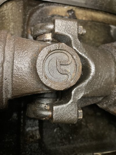

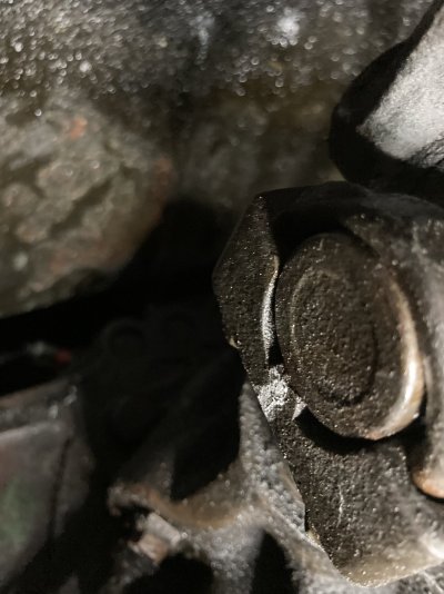

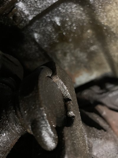

They ended up not completely seating and tightening the U joint. What a bunch of clowns.
