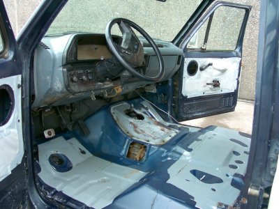

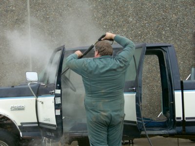

I go the car wash vac when I have to clean one, and I have been known to wash the inside of the truck with the pressure washer. MAybe not an option with cloth interior. Also the heater core comes out real easy behind the glovebox and will give very good access.
Here is what it looked like when done, if you can read the door you know why I steamed the WHOLE truck.

Dang Russ! First time I've seen that! LOL And here all the while I've be rolling my windows up when it rains. LOL

Russ's truck was sitting for a long time, and I'm sure in that pic the interior was gutted.
