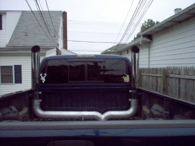

While I'm passing on a few cheap but not nasty V.E. tips, (the tuned length aircleaner pipe with a bell mouth on the end situated in a high pressure area), there is another cheap mod that you guys might be interested in trying. The engine has to pump the exhaust gas through the turbo, and then out through the system into 14.7 pounds of ambient air pressure. If you can lower the ambient air pressure at the exhaust tip/end then the engine can breathe easier. This idea came from a performance book written by Smoky Yunich, the idea is to situate the tailpipe tip in a low pressure area. If you are familiar with the venturi effect, then you know that a pipe sticking out into the airstream will create a slight vacuum as the passing air flows around it, so a simple side exit pipe can create a small amount of vacuum when the vehicle is in motion. Cutting the side exit pipe on an angle creates a larger pressure drop (as does a larger diameter exhaust tip), or alternatively a manometer and length of hose can be used to find a suitable low pressure area. Some vehicle manufacturers already use one of the low pressure areas for this purpose, check out these pics-
http://pictures.topspeed.com/IMG/crop/201002/2009-triumph-sprint-st-5_600x0w.jpg
This mod is most effective at hyway cruise speeds, when there isn't a huge volume of exhaust gas to expel.
