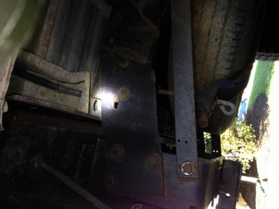

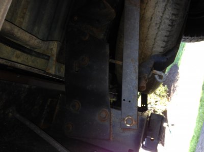

I have the same one on mine. I will post some pics tomorrow of how the po mounted it if that will help you.

Trying again. The center section of the bumper is about an inch less in width than the truck frame . So as you can see in last pic the plates have a bend in them. You could use flat plates and shim them.
