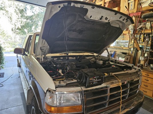

Sat 2 seeks unplugged.
Yea go look above for the date, 2012 or 14
Costco
