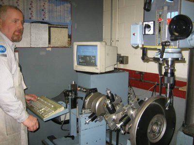

This is one of the balancing machines, called a dynamic balancer where the crank is spun. You can see the "bob weights" fastened to the crank, they take the place of the rods and pistons. If you have a postal scale, you can weigh and compare the assembled rod, bearings and piston with each other. That way it's not exactly within grams, but it gives you an idea of how close to each other they are.
