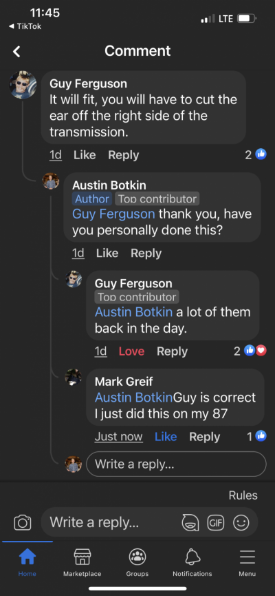

I’m hearing you can cut an ear off the zf bell housing to fit? Do you know anything about i
I went out to my parts pile, and set an 085 exhaust side on a 7.3/zf combo. It does look like it maybe could be made to work as far as fitting over the bell, with modding/cutting the bell, but the up pipe would have to be routed slightly higher and may have cab clearance issues also. The bellhousing may have to be cut enough, that welding in new would be needed.......
I personally dont think the 085 kit is really worth that amount of work. I have the same turbo on my truck, and have not put my zf5 in yet because of this. I have most of the parts to put a factory kit on my truck, and as soon as I finish collecting parts will be doing both at the same time.

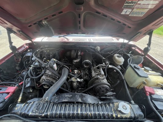

Thoughts?
I’ll be rockin this turbo kit for the near future probably until I get my settlement money lol it’s about all the 6.9 will handle anyways

Does it fit out of the box, no.
Do most things fit with cutting and welding, yes.
Have fun - document what you do and make a How to Modify ATS085 for ZF5 thread.

pm me a number I can send a picture to, and I will send a picture of what it looks like mocked up. will have time to do it later today.
