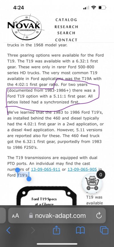

I’m trying to figure out exactly what t-19 I have to buy a rebuild kit
I bought 2 parts truck many years ago the guy pulled this kit his shed and said it was from one of them and the early 6.9 truck was missing the trans would be my best guess but not confident enough
Everyone says to just look at the tag on the top of the trans but I can’t find a decoder anywhere

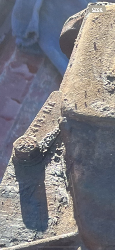

Tag says E4T3-MA
I have a feeling it’s the 5.11 verity just by the way it feels and I believe E4 means 1984 manufacture date which backs that suspension up
But I’d like to go off more than suspension thanks
