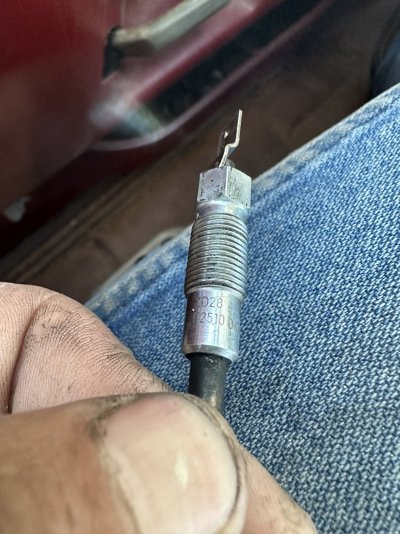

Got the dead glowplugs out. They arent bulged and came out easy. Any one see anything obvoius? They are motor craft ones from oreillys. As far as i can tell the button isnt coming on unless pushed.
Does the 6.9 have some kind of voltage reducer like the squilggly thing on a 7.3?
Thanks yall

do you have a good picture of the numbers on the plug? Sure dont look like beru to me.
If you are going to use manual control, use the bosch 80034 plug.
I think you're right. I see one number that looks like it starts "ZD2" and another one that looks like it says "ZD(unreadable)3". Neither one of those numbers are correct.
You're on to something, and reading that it struck me, that since the 87 6.9 went to the solid state GP system it should probably have the bullet top plugs. I went and looked at my tow truck which is an early 87 and it has the bullet style.
Yes that's right. Ford switched glow plug styles as well as the controllers in 1987. For some reason, probably related to International, they changed most of the things to the 7.3 style except for the engine.
