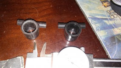

Icanfixall, I suspect the fuel filter light is coming on like that on account of a blocked line... It is the reason truck stalls out when I switch to the front tank... Hope to fix that tomorrow...
In preparation for the new return caps and o rings, I took some 200 sandpaper and smoothed the edge of the lip of the cap, that is, the part where the o ring makes first contact... It was too sharp of an edge for my tastes, so what the heck, why not make it easier to slide the cap over the o rings.
It doesn't start with a square edge into the insides of the caps, instead there is a slight bevel the first 50 thousandths of the cap wall... Right at the top edge where the bevel starts, it was like an abrupt turn towards the bevel... I thought it would be better safe than sorry to lightly sand that abrupt turn to make it easier for the o rings to start...
Anyway, here is a picture of one of the caps that has been deburred... the one on the left is the deburred one... Of course I used compressed air to clean them up... ;Sweet

That is exactly what I refer to about the flash area. I use an exacto knife to clean up this area for a smooth o ring penetration with plenty of lube...

Thank you Icanfixall for the confirmation.
The whole time, I thought you were referring to further in where the step sits... Past the return hole in the sides of the caps...
That was a good time for an epic facepalm...
